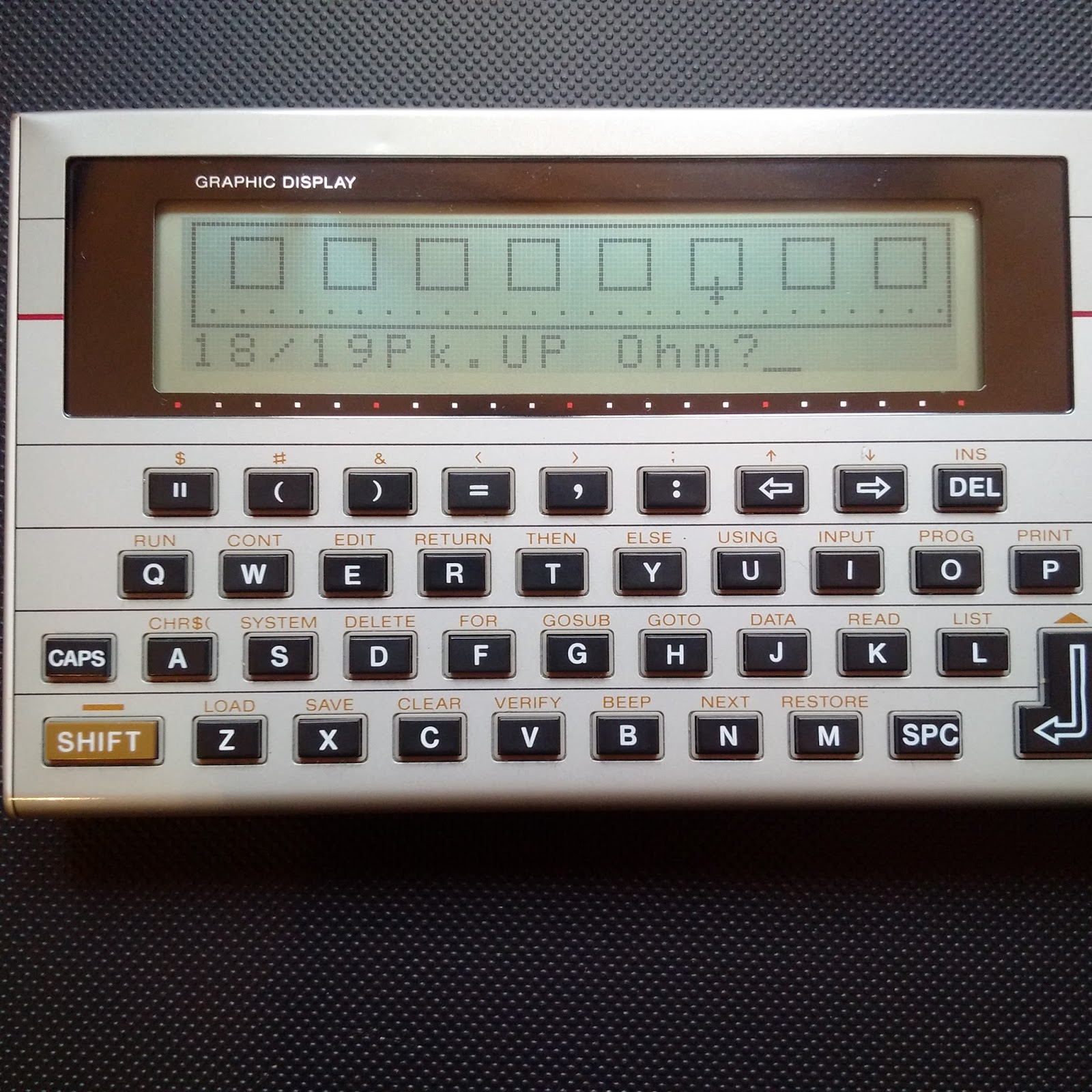

Here i've prepared my personal diagnostic plan about Woodward governor 2301 , it's possible to have problem on engine load and RPM control more often it there are more engine working on parallel, so i've study the disgnostic method and i've put all solutions on my CASIO PB 700!
WARNING! this is an example solution, checked only with few Caterpillar engine model, don't take it as bible..may be your plant it's different.
Call Always specialized technicians for service!

WOODWARD 2301
10 CLS:BEEP:LOCATE 2,0:PRINT”W O O D W A R D”
15 CLEAR
20 LOCATE 0,1:PRINT “2301 governor v.1”
25 LOCATE 13,2:PRINT CHR$(64)+”1982”
30 LOCATE 0,3:INPUT”start Y/N”;A$
40 IF A$=”S” THEN GOTO 100 ELSE END

365 DRAW(110,17)-(110,12):DRAW(109,16):DRAW(111,16)' FRECCIA SUL MORSETTO
370 LOCATE 0,3:INPUT”18/19 PkUP Ohm”;PO
375 GOSUB 1000
380 GOSUB 3000
385 DRAW(101,17)-(101,12):DRAW(100,16):DRAW(102,16) ' POS. FRECCIA
